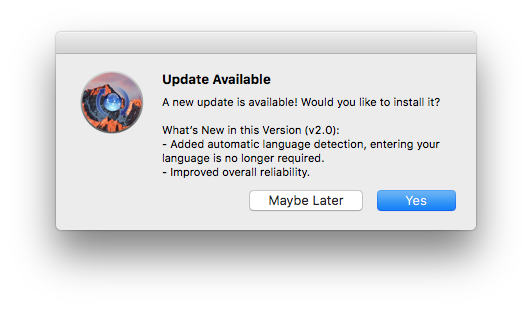

1.  Download a copy of the tool, and open it on your machine.
Main Window
*If an update is detected, please be sure to install it, as it will include support for the latest macOS Updates as well as new features.

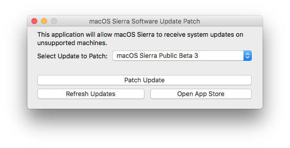

Update Available

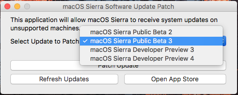

2. Select the software update you want to install, and click "Patch Update."
Update Selection

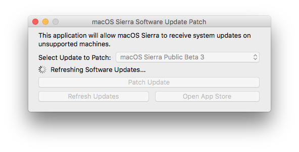

*If the program tells you that the update doesn't exist, click "Refresh Updates," wait for the process to finish, and try to patch the update again.
Refreshing Software Updates
